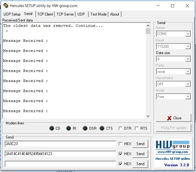

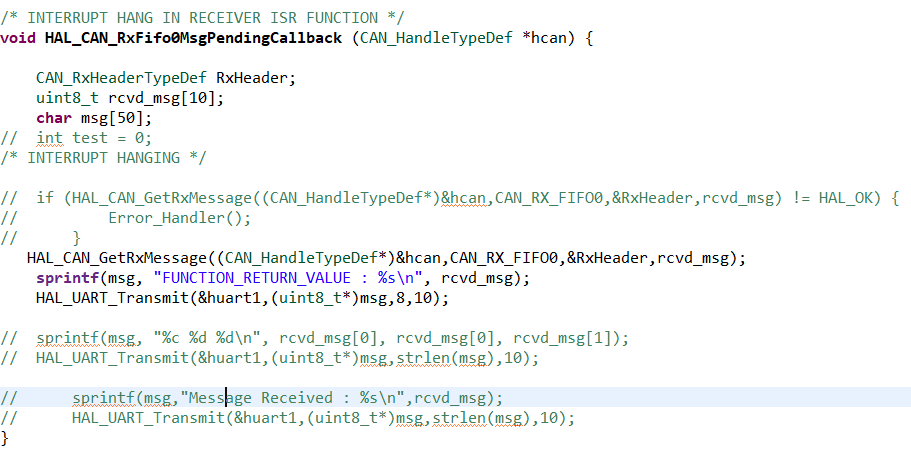

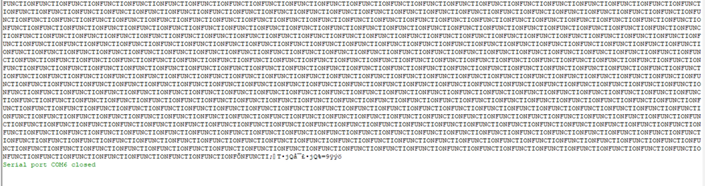

2020-06-29 12:49 AM
Yeah, I tried but it is still hanging in Receive Callback Function.
2020-06-29 12:52 AM

Callbacks done under interrupt context, would avoid calling things which can block, or have delays/timeouts dependent on other interrupts. Would avoid printing to uart.
Queue or buffer data to be handled off critical path.
Don't see you dealing with NUL termination. Post code in formatted code block, not screen grabs.
