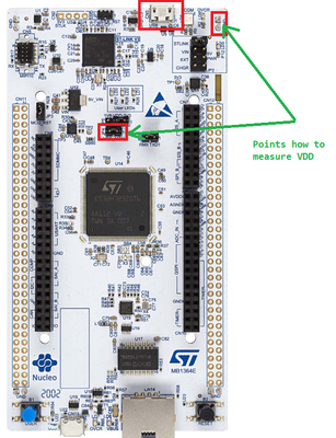

You need to post a picture of your board with an ST-LINK connection and show how do you measure VDD_MCU using a multimeter or something else ..

2024-09-06 3:45 AM
So, sorry for miscommunication from my behalf. I wanted to say that i have checked voltage in a wrong way. and after seeing the picture you shared me, i did it the right way and i am getting 0volts. and so i have a question. how much exactly i should get ?
