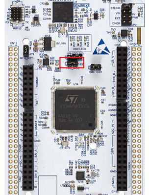

Did you check the power supply of the MCU? Check the jumpers, especially the ones related to the power especially JP4.

Yes i have checked the power supply of MCU, the jumpers are connected to that of JP4 and the data cable also. these two are not the issue. could you add more details why is it unable to upload the code.

Did you measure the VDD level on JP4?

How to measure the VDD level on JP4?
Could you please help me with that.

Use a Multimeter. Need to measure the voltage level between JP4 and GND.

19.6volts. And i have observed another thing which is, when the jumper is removed the LD5 is brightly on. When the jumper is placed, the LD5 is off. the multimeter voltage keeps on changing.

On VDD? how did you power supply your board?
