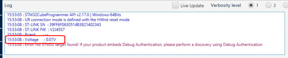

I am utilizing the STM32F767Zi microcontroller unit (MCU) on a customized printed circuit board (PCB). During the debugging process, we are using the ST-Link V2 ISOL debugger. However, we are encountering an issue where the MCU is not being detected in the Integrated Development Environment (IDE), nor is it recognized in the STM32CubeProgrammer software. We have verified the hardware connections and checked the voltages across the MCU, confirming that the power supply and connections are stable and as expected. Despite this, the issue persists, suggesting the need for further investigation into potential firmware, software configuration, or compatibility problems.

Your ST-Link is not seeing the Target Power:
Show your schematic.
