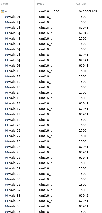

Every value in this array should be around 1500, but there are consistently values around 62941 showing up, with a regular repetition.

65535 - 62941 = 2594 ?
do you have the auto-reload set to 65535 - 2594 +1500 = 64441 = 0xFBB9 ?
No, to 4096.
And the "wrong" result comes exactly in 1500/4096*100% of cases, cca 37%.
The solution is called modulo arithmetics. There's also no need to use anything but the maximum ARR.

Somehow despite spending almost 4 hours on this and double-checking everything a dozen times, I manage to miss this typo here every time I checked:
htim3.Init.Period = 0xfff-1;It didn't help that I made the exact same typo in a second project I set up specifically to test the minimal case. I also noticed that when the pin was floating it would trigger interrupts at a similar rate to the 'wrong' values (50Hz possibly from mains AC?) which sent me down a pointless rabbit hole of suspecting hardware issues.
Anyway with the correct value of 0xffff-1 everything is fine. Maybe I shouldn't be coding so late into the night with a foggy brain...
