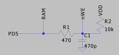

so if you dont need hi speed on the nWE , but on PD5 want hi speed,
you could put a resistor + cap in the line to nWE , preventing fast spike just for this ,
and let PD5 on hi speed setting.
