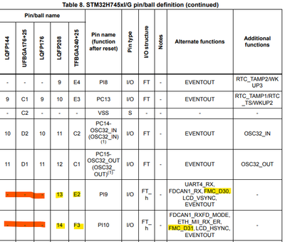

Can I connect a 32bit bus SDRAM to STM32H7 and assign the FMC IOs as I wish or should I stick with the Alternate functions of the GPIOs?
Specifically: can I map 32 GPIOs to STM32H7 models with 144 LQFP package where the GPIO for D31, D30 etc.... (PI9, PI10, ...) are not exposed?
Is there a LQFP STM32H7 with 32bit bus exposed?
No, you can't choose any pin. Only those with the FMC_* alternate function can act as those pins.
The LQFP208 seems to have all necessary pins.
