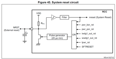

This chip has the nWE pin not for nothing. What if you link it to NRST so that write automatically gets disabled in unfortunate moments?

Hi @Pavel A.
We measured the sequence of nWE and nRST pins and the nRST signal is activated much later, after the problems on the pins I described.

Hi @EngyCZ ,
This is intriguing, as it defeats the very purpose of the nRST output signal (as a way to convey the internal reset signal to other circuitry). Here you are talking about the case when nRST occurs from "inside" the mcu, such as watchdog, I presume.

2025-05-05 4:12 AM - edited 2025-05-05 4:14 AM
Hi @waclawek.jan & @Pavel A.
OK, a small correction. The voltage on the nRST pin starts to decrease simultaneously with the nWE glitch. However, it is not as fast as nWE probably because of the capacity 100nF on the input.
Thus, in the "digital" world, nRST switches to 0 later than nWE.
