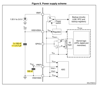

Check the connection of VDDA and VREF+ pins - they should both be at 3.3 V.
2025-12-25 12:05 AM - edited 2025-12-25 12:05 AM
2025-12-25 6:14 AM
Definitely sounds like VREF+ is not connected properly. Is it floating? Consider showing the schematic. Ensure decoupling caps are present.
2025-12-25 7:22 AM
YES!! ISSUE RESOLVED... VREF+ WAS NOT CONNECTED PROPERLY
