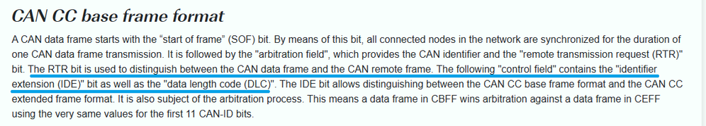

Hello @Kamil_16 and welcome to the ST community,
That's a generic question on CAN protocol not linked to STM32. (https://www.can-cia.org/can-knowledge/can-cc:(
What do you intend to mean by "complex system"?
