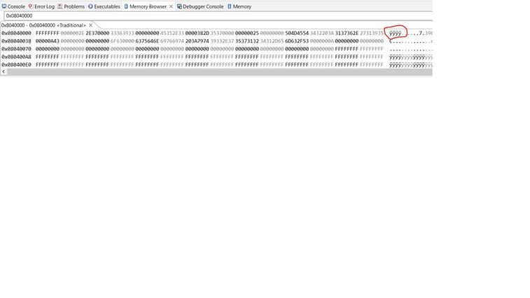

I initialized string array with strings and type cast to uint32_t to store in flash memory as uint32_t. And then read the array as uint32_t. I update one of the string of the array and type cast uint32_t to store that array in Flash memory back. But whenever I update string value and store on the flash memory. The string has strange characters on it. If you see the string that I am trying to store in string array "21.76".
But in flash memory showing as "yyyy6.Its not storing properly.If you see the picture below in memory browser its showing as "yyyy6".
I dont know why?. Any suggestions.

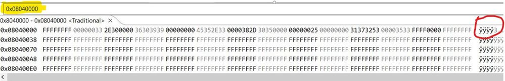

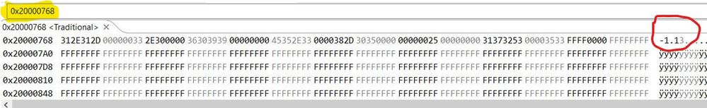

I put some breakpoints before the MY_FLASH_WriteN() and I can see according to the address of the CStore. It contains string before writing to the flash. If you see the memory window, After the MY_FLASH_WriteN() characters are not written properly into the flash memory. If you see the memory window,
I have DMA configured for UART to receive data. Is there possibility that processor gets interrupted while it try to write to Flash. And then it stops writing properly to the flash. But I wait it for flash writing to finish before I receive any data from UART. I wait for 3 seconds. Is 3 seconds enough for flash writing. Any suggestions will be very helpful.

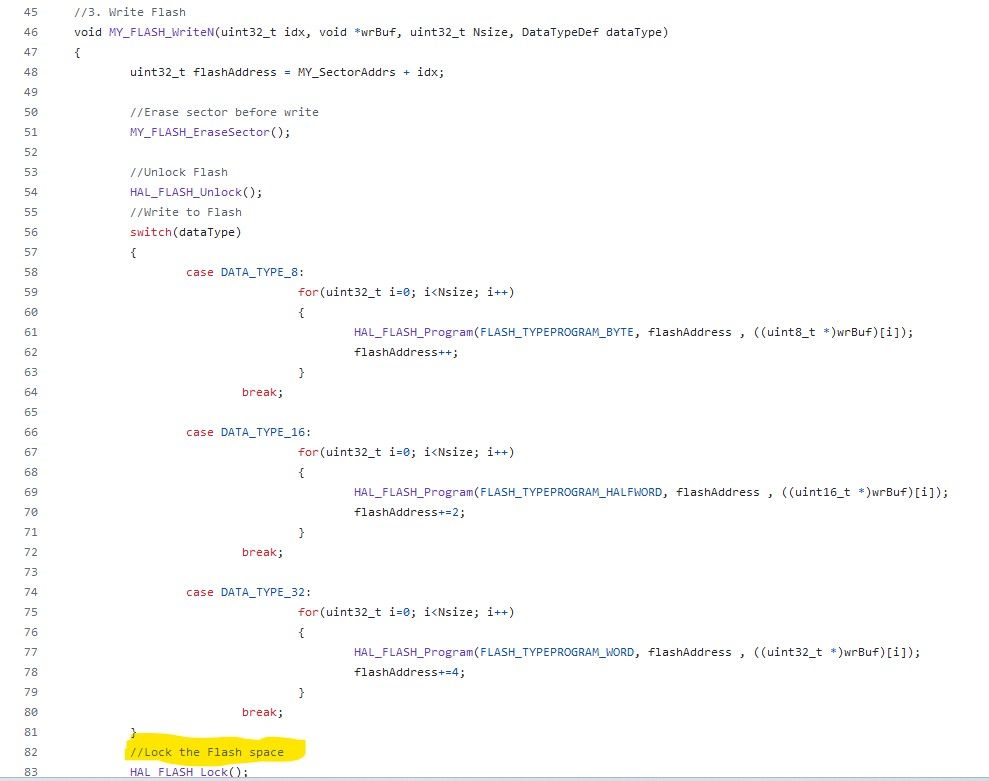

I put some breakpoints on the library file (MY_FLASH.c) just before the HAL_FLASH_Lock() on the HAL_FLASH_WriteN. I can see that in sector 0x08040000 characters are not written properly into the flash memory. I dont know whats going on there. Is there possibility that sector is bad or processor gets interrupted during the write operation. Or the flashAddress is not sequencing?
2024-04-23 6:37 AM
Firstly check is sector erased on line 51?
2024-04-24 2:17 PM
I put a break point on line 51, I can see the sector is being erased.There is nothing contains after erased. There is another strange factor if I change on DATA_TYPE_8 on MY_FLASH_WriteN it seems to work. It is only byte of data. On this string contains 5 bytes of data.I dont undestand whats going on there?
