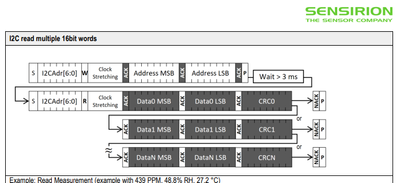

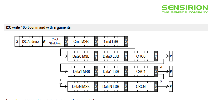

So the sensor supports I2C, MODBUS, and PWM - are you sure you have it in the correct mode?
The transmit is only 11 bytes of data: the I2C Address is specified separately - not included in the buffer:
For receiving, it's (up to) 9 bytes of data:
The sensor datasheet shows example scope traces - compare them to what you're seeing.

I'm familiar with I2C protocol, used to work for Philips Semiconductor..
The protocol for the sensor doesn't send 12-bytes in any circumstances.
It sends a 16-bit command, and then multiples of 3-byte parameters, ie 16-bit data + 8-bit crc.
So 2, 5, 8, 11,.. etc bytes per interaction. Didn't look at the Read methods
The CRC is described, and can be computed in SW, with low effort.

2024-04-24 10:01 AM - edited 2024-04-24 10:02 AM
As I read it a singular 5-byte write transaction.
