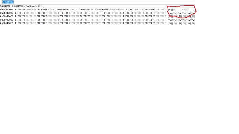

I initialized string array with strings and type cast to uint32_t to store in flash memory as uint32_t. And then read the array as uint32_t. I update one of the string of the array and type cast uint32_t to store that array in Flash memory back. But whenever I update string value and store on the flash memory. The string has strange characters on it. If you see the string that I am trying to store in string array "21.76".
But in flash memory showing as "yyyy6.Its not storing properly.If you see the picture below in memory browser its showing as "yyyy6".
I dont know why?. Any suggestions.

2024-04-12 11:46 PM - edited 2024-04-13 12:10 AM
Here is the code.
if(strncmp((char*)ptr, "tempc", 5) == 0)
MY_FLASH_SetSectorAddrs(6, 0x08040000);
if (strncmp((char*)ptr, "tempc1", 6) == 0)
Counter = 0;
MY_FLASH_ReadN(0, (uint32_t*)CStore, sizeof(Ctore),DATA_TYPE_32);
HAL_Delay(100);
memset(CStore[Counter], '\0', 10);
for(char *str =strtok((char*)ptr, " "); str; str = strtok(NULL, " "))
if(strncmp((char*)str, "tempc", 5) == 0)
continue;
strncpy(CStore[Counter], str, strlen(str));
Counter++;
MY_FLASH_WriteN(0, (uint32_t*)CStore, sizeof(CStore), DATA_TYPE_32);
HAL_Delay(100);
2024-04-12 11:53 PM
Flash possition can be writed only once. For next write require erase before. And your code is chaos of pointers.
Read and apply EEPROM emulation code for STM. an4894-how-to-use-eeprom-emulation-on-stm32-mcus-stmicroelectronics.pdf

Declarations ptr CStore ???
memset(CStore[Counter], '\0', 10);is absurd if CStore is char array etc.
2024-04-14 10:28 AM
char CStore array contain old string after read from MY_FLASH_ReadN, I just wanted to clear out that string with memset and write the new string to the CStore array. And then store in flash, thats my thinking.
