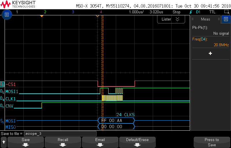

2018-10-30 8:26 AM
OK, I got this to work as follows (thanks again for the pointers @Community member @Bob S !):
Here's the picture:
PS: As you guys hinted, the HAL/LL stuff was more in the way then helpful, so I ended up doing the peripheral initialization the old-fashioned way (const structure to initialize entire peripheral register set, then enable when ready). Also CubeMX-generated code failed to initialize all the required registers.

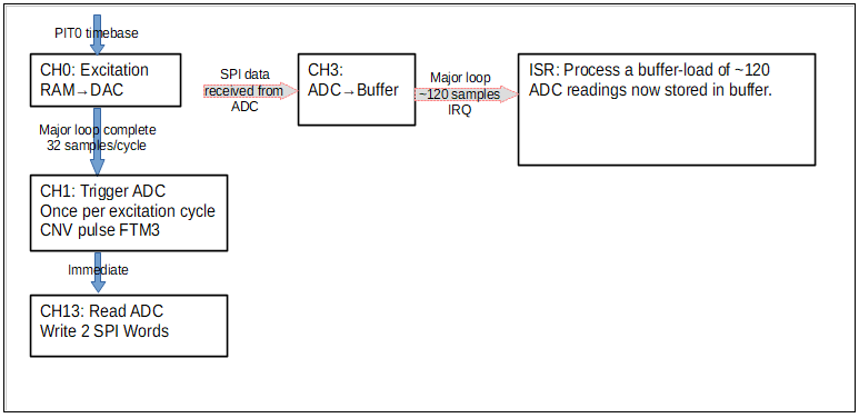

2018-10-15 2:33 PM
PS: Here's an example of what we did with a different vendor's DMA: Send excitation waveform via onboard DAC, initiate ADC once per excitation cycle, read ADC, accumulate 120 samples in a buffer, then invoke ISR. No CPU involvement until a pile of samples ready. Used 4 DMA channels and DMA chaining. Yes, ADC transfer was >16-bits (this MCU's SPI module supports >16 bit SPI with multiple transfers while holding CS):
