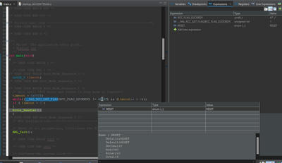

The problem is in this line:
while((__HAL_RCC_GET_FLAG(RCC_FLAG_D2CKRDY) != RESET) && (timeout-- > 0));
and the rcc_get_flag is problematic until the timeout variable goes -0 and then you get error handler:
int main(void)
/* USER CODE BEGIN 1 */
/* USER CODE END 1 */
/* USER CODE BEGIN Boot_Mode_Sequence_0 */
int32_t timeout;
/* USER CODE END Boot_Mode_Sequence_0 */
/* USER CODE BEGIN Boot_Mode_Sequence_1 */
/* Wait until CPU2 boots and enters in stop mode or timeout*/
timeout = 0xFFFF;
if ( timeout < 0 )
Error_Handler();
2024-01-24 8:00 AM
@Kyrpav I suggest you disable boot sequence to be able to debug CM7.
Here is why.
RCC_FLAG_D2CKRDY
is released by CM4. Since you are stepping in debug it could not be released at the right time.
