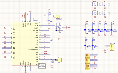

I have setup a base board of ADE9000 With only Basic Components connected, Like Bypass capacitors, Reset pullups and connected SPI Directly with the STM32F401 Blackpill board , Everything starts-up perfectly.

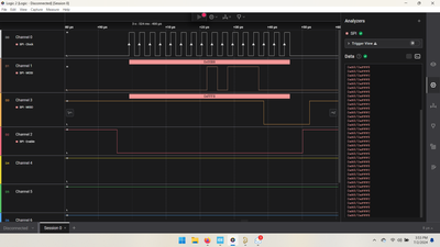

SPI for STM32F4 is set to 16 bits with Mode 0 Configuration and I am checking the data using Logic Analyzer which check out that the data sent from the MCU is 0x4FE8 but receiving is 0xfffc and/or 0xfff8

Please post your code & schematics, and logic analyser traces - see:

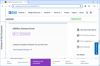

Have you tried the Software Driver which ADI provide?

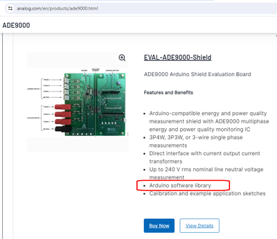

It seems there's an Arduino library available:

I have made a custom board for ADE9000
