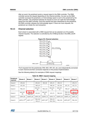

DMA1 Stream5 has no trigger from TIM2_UP:

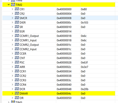

Read our and check/post TIM and relevant DMA registers content.
The only (IMHO) relevant difference is DIER where UDE or CC1DE is 1 but that is quite obvious as this is the objective of the program. It seems that DMA request are not sent by TIM to DMA controller, but I have no idea why.
The fact that DMAR has different values is the result rather than the source of the problem.
I added all DMA1 registers and TIM2 to the document (see chapter 6-7-8-9 of the attached document)
Below TIM2 in the case where UDE does not start DMA cycle (but TIM2-ISR-UIF is still called many times?).
Johi
Senior III
@waclawek.jan thank you very much for the solution, when I read 10.3.3. in RM0090, i interpreted the text as channal for data not for trigger. Afterwards i found out that all DMA passes via DMAR for timer in burst mode. But it did not cross my mind that my reading of 10.3.3. was also wrong. Again much appreciation for your support to the forum.
