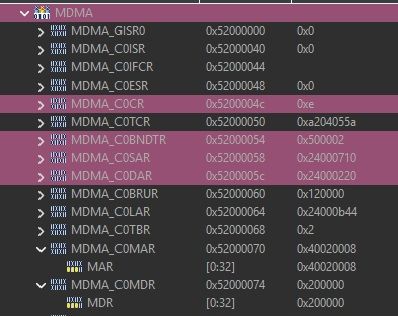

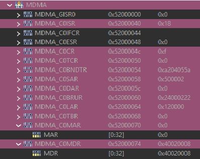

So I checks MDMA registers and I saw something I don't understand :
normally (if I well understood the manual) at the end of the first repeat block transfer, the MDMA registers C0MAR and C0MDR are used to reset the TC flag of DMA (ADC).
but when the function "HAL_MDMA_Start_IT" is executed, and at this line :
/* Enable the Peripheral */
__HAL_MDMA_ENABLE(hmdma);
the both registers C0MAR and C0MDR are lost.
before the call of the macro __HAL_MDMA_ENABLE, C0MAR = 0x40020008 and C0MDR = 0x200000 that is correct, and after the macro is executed; registers C0MAR = 0x0 and C0MDR = 0x40020008.
Before macro :
Before macro
After macro :
After macro
it seems the registers are shifted ?!

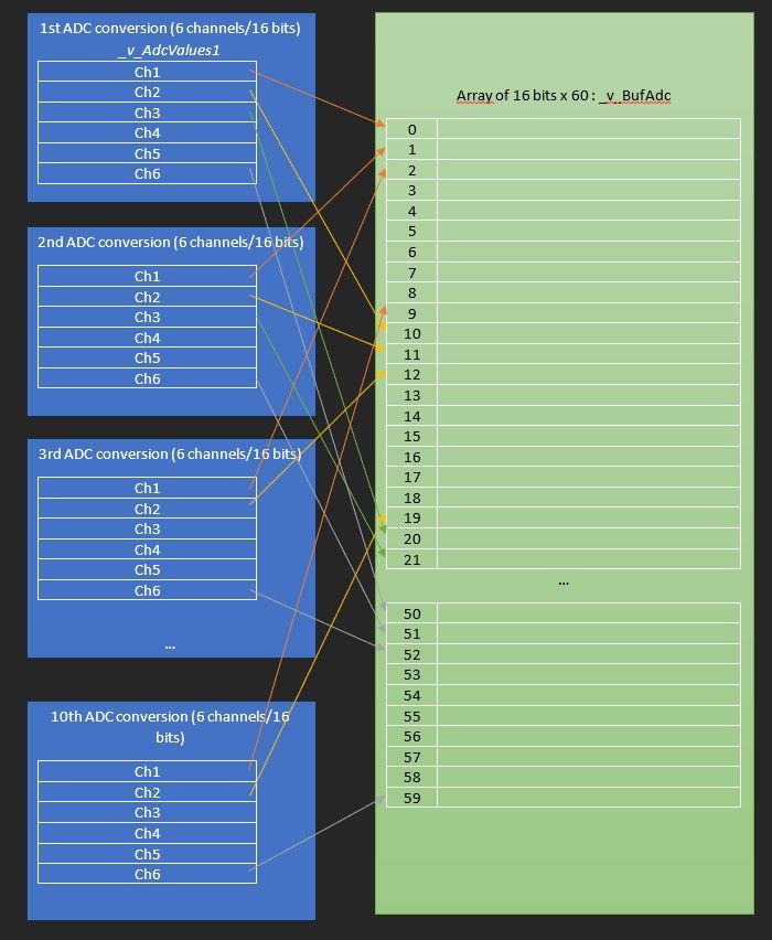

This means the destination address is incremented by 18 bytes at the end of each block. So, the destination address appearing shifted in the registers is also expected behavior.
-> yes that correct, I draw a bitmap to explain the behavior I would like to have :
So for the first Adc conversion, it's ok, I have the values on index 0, 10, 20, 30, 40, 50
But the issue comes on the first linked list that doesn't work. And MDMA registers are shifted with bad values.
Best regards,
Laurent

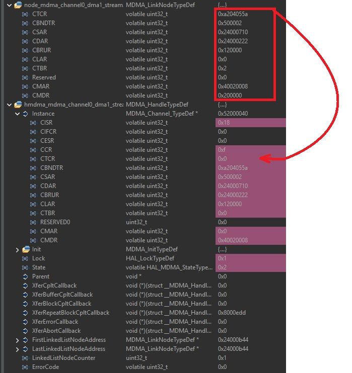

2026-05-07 7:17 AM
this the copy of memory and MDMA registers when the software halt inside MDMA_RepeatBlockTransferCompleteCallback function :
normally the structure node_mdma_channel0_dma1_stream2_tc_1 is copied to registers after first node executed :
MDMA_CxTCR, MDMA_CxBNDTR, MDMA_CxSAR, MDMA_CxDAR, MDMA_CxBRUR, MDMA_CxLAR,
MDMA_CxTBR, MDMA_CxMAR and MDMA_CxMDR
but here, it seems that the structure is copied starting from register CBNDTR instead of TCR ???
best regards,
