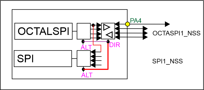

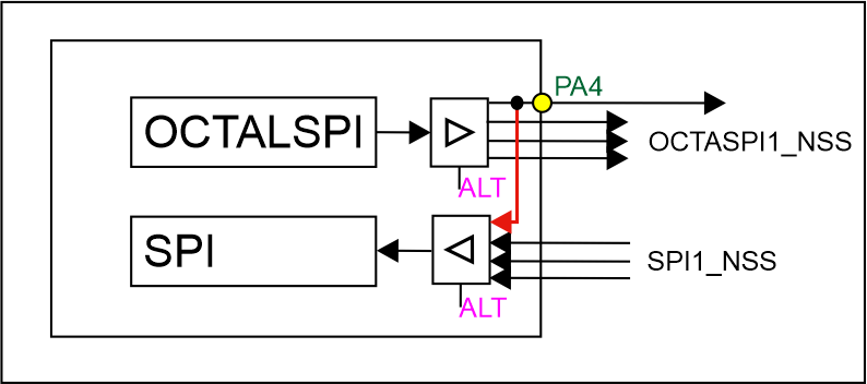

2024-01-20 5:57 PM
I mean this:
A) the input signal is taken from the pin (directly) - OK
Why it should not be possible?
It just depends from where the pinmux selects the signal (and if it would affect the DIRection when setting an ALT):
B) the input signal is taken before the GPIO cells and ALT affects also the DIRection - FAIL
Best would be:
If the pinmux is "just" a mapping of which signal goes to which pin (pad), but the direction is not "hard-coded", it should work, to connect an input to an existing output (internally).
If any ALT config affects also the pad (pin) DIRection: sure, it fails.
(as it looks like pinmux in chip is implemented this way)

2024-01-20 5:57 PM
I mean this:
Best would be:
