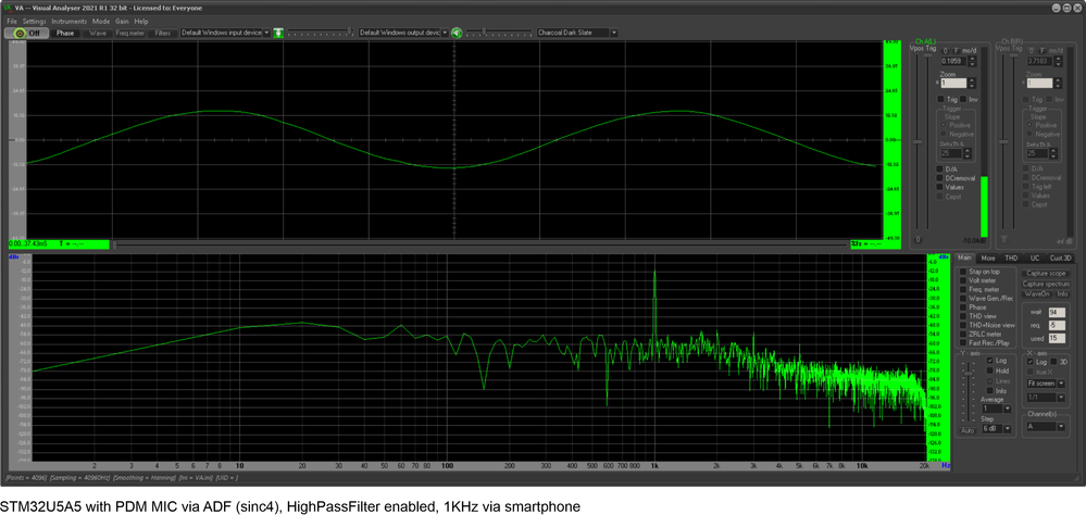

So, PDM MIC via ADF on a STM32U5A5 works fine now.
And: it is much better as any software based PDM2PCM approach (e.g. using this SW filter on a Portenta H7).
I do not see the harmonics (artefacts), it sounds much better, just the volume level is lower (but I can correct in the SW, in the "digital domain", e.g. scaling before forwarding the PCM sample values).
Here, how it looks like with ADF as PDM MIC input and a 1KHz sine wave from smartphone (pretty good):

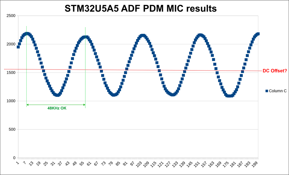

2024-05-14 10:00 PM
BTW: I have played with the gain for the ADF filter.
The comments in code say this:
/*!< Filter gain in step of around 3db (from -48db to 72dB). This parameter must be a number between Min_Data = -16 and Max_Data = 24 */
What happens is:
I "must" get rid of this DC Offset, otherwise the gain setting does not make any sense!
It would move the DC Offset into saturation and the signal is clipped/lost (and not really amplified).
How to avoid this DC Offset?
