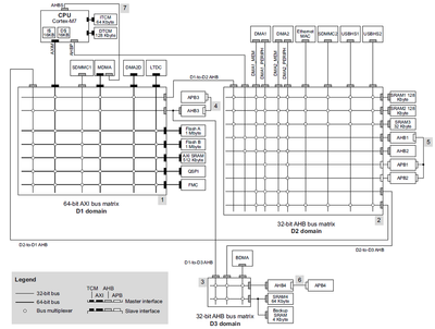

Hello @fwald ,
The problem is most likely the RAM location of your buffer.
On STM32H7 devices, the DMA cannot access DTCM/ITCM memories. Those memories are tightly coupled to the CPU, so even if the DFSDM is working and FLTRDATAR is changing, the DMA transfer will not complete if the destination buffer is placed there.
This is visible in the block interconnect matrix from RM0433:
So please make sure your buffer is located in a DMA-accessible RAM region, for example SRAM1 or SRAM2.
You can do that by placing the buffer in the proper section with an attribute macro, depending on your linker script, for example:
__attribute__((section(".RAM_D2"))) int32_t LeftRecBuff[1024];
or another SRAM section that is accessible by DMA in your project.
You can find more details about this kind of issue in the community article linked here.
Also, if D-Cache is enabled later, remember that cache maintenance may be needed for DMA buffers.
So, in short:
Move the buffer to SRAM1/SRAM2, and the callbacks should start working.
Best regards,
DHIF Khaled
