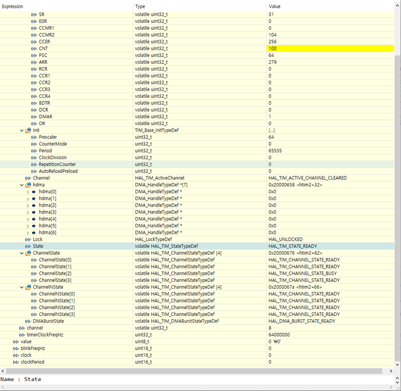

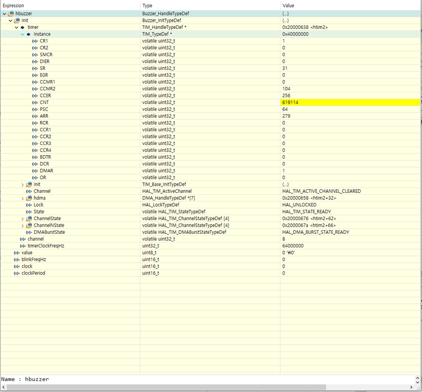

waclawek.jan
Super User
> However, when I try to control them simultaneously, the buzzer does not sound.
Read out and check/compare-to-working/post TIM registers content, for working/non-working setup.

When you first call the function, the buzzer and PWM operate normally,
But when you call the function the next time,
The buzzer does not operate normally and only the PWM operates normally.

We set a break point and analyzed the case closely.
When it's normal
TIM_HandleTypeDef
TIM_TypeDef *Instance; in
CNT; /*!< TIM counter register,
The value is within the normal range, but when there is no sound, there is a large value as shown below.
If we are trying to solve this, how should we solve it?
normal sound buzzer img = cnt range 100~ , 200~ , etc...
error sound buzzer img = cnt range 7237947, 619114 etc..
waclawek.jan
Super User
If you change TIMx_ARR in running timer (or stop timer for the TIMx_ARR change but don't clear TIMx_CNT) , use the ARR preload, i.e. set TIMx_CR1.ARPE.
