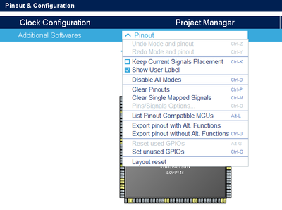

I attach a csv file generated from the STM32CubeMX => Pinout => Export pinout :

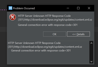

I tried updating but initially it was stuck for half an hour at 39% (I have high speed connection) then after restarting it and also the PC it gave the error shown in the box below. Any suggestions on how to solve it?
Thank you
2024-10-29 9:40 AM
Response code 301 means "moved permanently". I guess you have an old STM32CubeIDE version with built-in broken links.
Please try upgrading to latest one (1.16.1):
