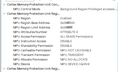

I have no experience working with MPU but I managed to make it work.
These are the CubeMX settings that worked for me:
If I set something wrong, I would appreciate it if someone could point it out.
