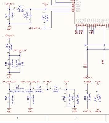

Below is the schematic screenshot

1. Why do you have HAL_Init(); commented out?
2. The NUCLEO-H755ZI-Q board does not have an external HSE crystal connected, but your custom board does. Are you configuring the clocks properly for your board?
3. Do you have the same SMPS section layout, and have you set the HAL_PWREx_ConfigSupply(uint32_t SupplySource); configuration appropriately for your board?

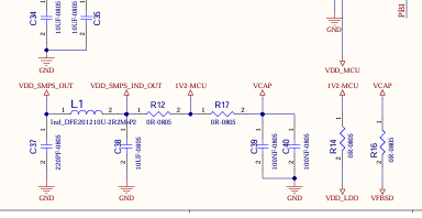

3)
Yes I think its same as nucleo Board Please check above part of smps power supply.

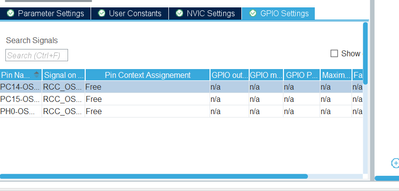

2025-11-11 4:16 AM
And Please let me know why there is free in pin context Assignment as i am using cortex m7 it should be cortex m7 right?If no how to change to cortex m7 or this is the reason of not working the code?
these are pins of oscillator.
-For the oscillator pins, this is the normal behavior of CubeMX when assigning oscillator pins.

>But here in this project for oscillator pins its showing cortex M7 Pin context assignment.
>yes, I tried this but still it's not working.

I'm not sure this is true as the code you shared is very simple and I'm pretty sure the SMPS power supply was not configured meaning the MCU was set to be powered with LDO and I have the impression that you've locked the MCU. According to your schematic (blurry image and bad quality), I can conclude the hardware is configured in SMPS:
So please review this knowledge base: How can I recover my STM32H7/STM32H7RS board after facing a power configuration deadlock?
