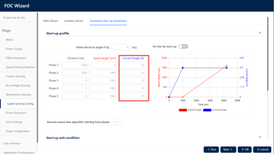

For overcurrent, reduce the current target.

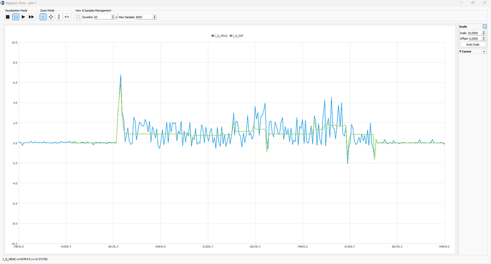

In the meantime, I checked whether my current‑measurement setup might be contributing to the behavior. Could you please take a quick look at the attached screenshot of Iq_Meas and let me know if this level of noise is considered normal? Even when Iq_Ref is stable, I see approximately 2 A peak‑to‑peak noise on Iq_Meas. Is this expected?
If not please can you let me know what should I check further?
Thanks a lot.
2026-02-24 11:32 PM
Hello @ElGuerrero91,
On the EVSPIN32G4 board, by default, Motor Control Workbench directs the overcurrent limiter and driver protection signals to the same timer input, TIM1_BKIN. This configuration prevents the digital filter duration from being taken into account. On the EVSPIN32G4 board, the TIM1_BKIN2 input can be used for the overcurrent protection.
For the current sampling, did you align the sampling timings described in the Current sampling chapter of the User manual with your custom board components?
