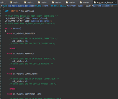

2025-05-24 9:16 AM
in USB event loop you can see it -> i set a global info then, usb IN or not...
