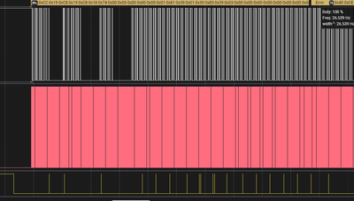

Also in logic analyzer that ı set for spi, I can kind of see the pulses but they and also CS pin are very unstable.
2025-06-18 12:41 PM
Update: I was running spi at 10MHz to be able to measure logic pins(Analyzer can go 24Msps max). When I took SPI to 20MHz, the CS line is stable but there is a chance that I am not able to capture it because of insufficient Msps.
This is the data to be sent from spi(3 Pulses):

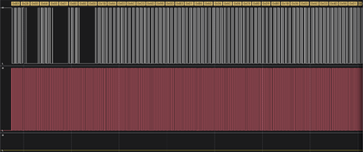

This is its SPI transmission:
Is there a way to plot the data being sent because I am not sure if this is correct.
