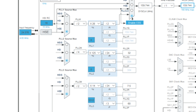

I'm facing a MIPI DSI configuration issue with my STM32U5A9 and TFT LCD. When using PHY DSI as the DSI lane byte clock source, my code fails with a timeout on HAL_DSI_ShortWrite. When I switch to PLL3P, the initialization proceeds, but the LCD displays distorted images.
Request for Assistance: I'm new to MIPI and suspect a misconfiguration in clock settings. Any insights on proper configurations or similar experiences with STM32U5A9 MIPI DSI would be greatly appreciated.

Hello @UKhan.2 ,
Are you using DSI ULPM mode?
If it is the case, I advise you to take a look to DSI_ULPM_DataClock . In this example the DSI clock should be derived from the clock tree PLL3.PLLP (ck_plldsi) clock for instance to allow a switch-off of the PLL DPHY to save power during the ULPM phase.
More information about the clock configuration in README.md.
I hope this help you!
Kaouthar
2023-11-28 7:46 AM
Yes, we are using DSI ULPM mode, and we started with the DSI_ULPM_DataClock example. We've adjusted the configurations for our 320×480 RGB888 display, following their suggested clock source (PLL3.PLLP). However, we're experiencing a distorted image on the screen, and the displayed colors don't match our intended ones when drawing shapes like rectangles. Any suggestions on resolving this issue?

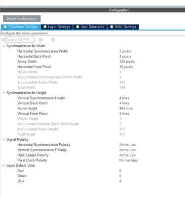

LTDC Clock Calculation:
In my current understanding, I am utilizing the following formula for FPS:
Fps = LCD_PCLK / ((LCD_WIDTH + LCD_HBP + LCD_HFP + LCD_HSW) * (LCD_HEIGHT + LCD_VBP + LCD_VFP + LCD_VSW))
Additionally, for MIPI configuration:
mipi_mbps = ((LCD_WIDTH + LCD_HBP + LCD_HFP + LCD_HSW) * (LCD_HEIGHT + LCD_VBP + LCD_VFP + LCD_VSW) * fps * 24) / MIPI_LANE
Might I be directed to the specific section in the LTDC datasheet where the relationship or formula connecting the display parameters for LTDC clock calculation is outlined? I can't seem to find that there.

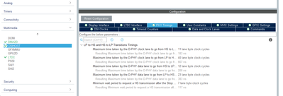

In relation to the HS to LS and LP to HS timings, could you recommend specific values?
Uncertain about the necessity, I have an external oscillator operating at a frequency of 24.576MHz serving as the input frequency:
Any additional insights or specific recommendations you can provide would be immensely helpful.

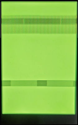

If the colours and lines mess up, it's likely a frame buffer or geometry issue.
2023-11-29 9:56 AM

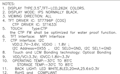

If you have a 320x480 don't set parameters for the active to be 304x464, that aint going to work
Are you sure the screen/buffer aren't rotated.
Provide a SPECIFIC part# and data sheet for the DISPLAY, it'll save a lot of confusion and wasted time/effort.

I appreciate your responses and insights into resolving the display issues we are currently facing. Based on your recommendations, I have a few follow-up questions to seek further guidance.
1. Debugging Frame Buffer or Geometry Issues:
Could you provide guidance on how to effectively debug and verify whether the observed issues are related to frame buffer or geometry problems? We want to ensure we address the root cause accurately.
2. Addressing Color and Line Distortion:
Attached is a picture of our display, which is not rendering as expected. Instead of a white color with clear text, we're experiencing color and line distortions in the displayed content. Any insights on rectifying this issue would be immensely helpful.

4. Display Part Number and Datasheet:
Our custom display utilizes the ST7796 controller. I'm providing the controller details below. Additionally, I've attached the datasheet for your reference.
Datasheet: [Attached]

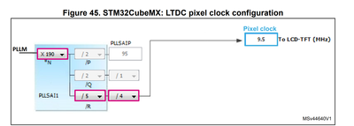

I'm reviewing AN4860, specifically the 5th DSI host configuration section and the 6th STM32CubeMX configuration example section.
I do have one question: Could you clarify whether the Pixel clock being set there :
is equivalent to the LTDC Clock in my case?
I'm unable to locate the pixel clock setup in my .ioc file.
Appreciate your assistance!
