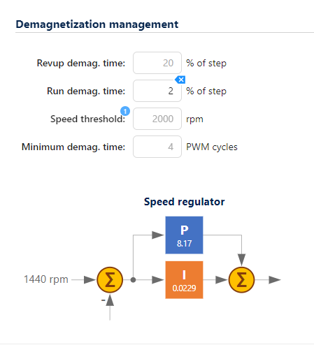

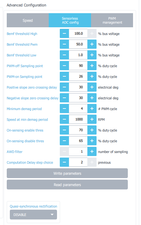

This behavior occurs after commutation and during the demagnetization phase. You can perhaps attenuate this behavior by changing the method used to compute the demagnetization delay. The demagnetization delay follows the speed information. At a certain speed threshold, the delay remains fixed. The STM32 Workbench and Motor Pilot tool allow you to change those parameters:
Into the STM32 Workbench:
Into the STM32 Motor Pilot:

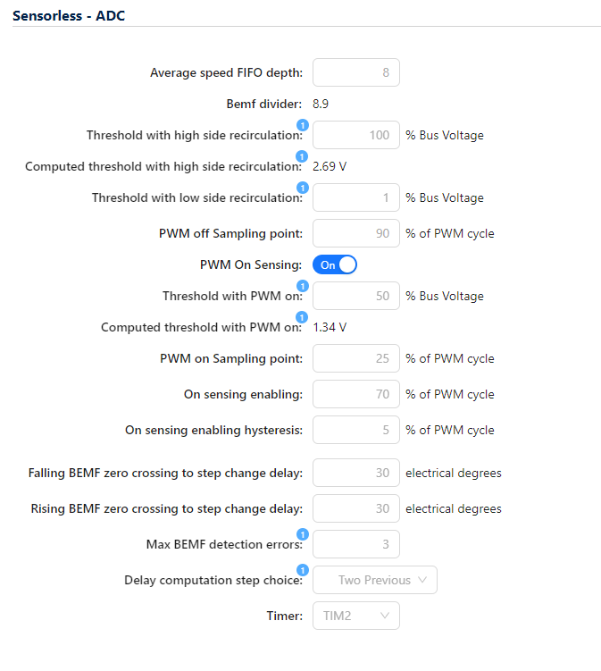

If the problem occurs during PWM-OFF zero-crossing detection, switch to PWM-ON zero crossing detection by changing the hysteresis value of the switch mechanism earlier. Change
"PWM on Sampling point" and "On sensing enabling".
