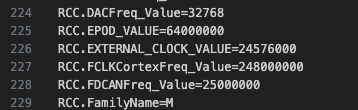

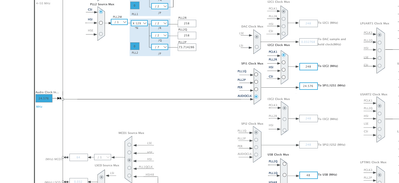

I'm trying to use an external audio crystal with a frequency of 24.576mhz, after setting the new frequency in the clock configuration tab, I get the right value in the .ioc file.
However, "EXTERNAL_CLOCK_VALUE" doesn't seem to be defined in the stm32h5xx_hal_conf.h file, and the default 12288000UL value will be used instead.
This makes audio all choppy and distorted, unless I manually define "EXTERNAL_CLOCK_VALUE" in this file to 24576000UL.
