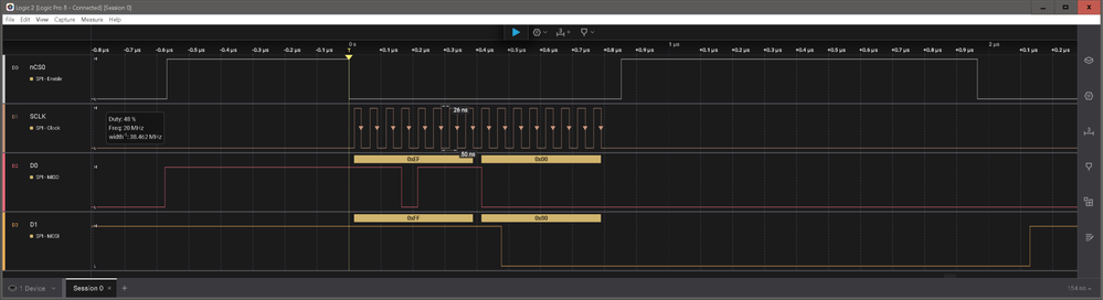

I am debugging the chip since hours and I think there is something wrong with the PB5 and PB15 pins:
1. SPI1 with MOSI on PB5:
I have configured SPI1 and want to get the SPI1_MOSI on PB5 (as mentioned as ALT5 in datasheet).
I use a STM32U5A5 with LQFP64 package.
Nothing comes out as MOSI (constant high, no bit pattern driven by SPI1).
But:
Just:
PB5 is NOT a SPI1_MOSI as mentioned in datasheet!
And: if I connect with SWAP configured (PB4 is MOSI) with PB5 (now as MISO): the waveform is damaged!
There are not anymore nice bits out of MOSI: so, the PB5 seems to be driven all the time, with something else (see below on Remarks).

PA15 = SPI1_NSS - no pull-up/pull-down - but: I see that NSS signal is released between SPI1 transaction:
even enabling pull-up on SPI1 PA15 config - does not solve the problem (just an external pull-up does!)

Why is NSS floating between transactions?
So far, fine. But why is SPI1_NSS released between transactions?
Even I configure with GPIO_PULLUP for PA15 - it seems to be floating (going to low on scope). Just an external pull-up fixes the issue (to keep NSS high all the time, what I want to see).

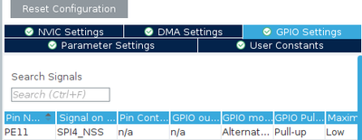

2024-03-17 12:55 AM
Maybe because you didnt "tell" Cube , what you want ?
you can set pin pullup:
and/or keep line state activ:
+ then : its still not doing, as you want it ?
