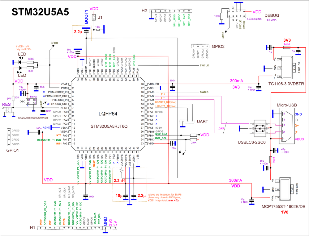

I want to run MCU with VDD 1.8V (in order to have all I/O-signals as 1.8V). I changed to use a LQFP64 package which provides a dedicated pin for VDDUSB.
I power VDDUSB with 3.3V (for sure not below 2.7V) but all other VDDs on MCU are 1.8V:
MCU seems to run with VDD a bit below 1.8V, e.g. 1.794V. But USB is not working anymore!
For USB I need at least 1.804V: then boot is OK, USB comes up and later VDD can drop to 1.793V and still working (but not booting up properly with USB on 1.793V: no USB enumeration anymore).
All my 1.8V ordered and soldered LDOs do not work - because they provide just 1.79xV: USB does not come up.
And the debugger (external ST-Link) becomes flaky with VDD a bit below 1.8V (50% of the tries it does not find the target).

I use SMPS (see comments below).
Schematics are attached here.

STM32U5A5/STM32U575 MCU board (with LQFP64 package)

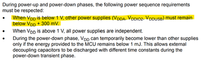

Is VDDUSB at/below VDD during power-up?
