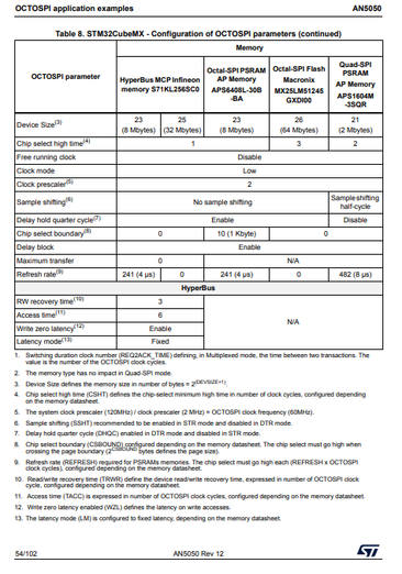

Hello @nkartik;
Could you please check your OCTOSPI configuration and precisely Read/Write recovery time, access time and Latency. For that I recommend you to look at AN5050 Table 8; may help you.
Thank you.

2026-01-27 11:56 PM
Hello @nkartik ;
Glad to know that the issue is solved and thank you for sharing the solution.
