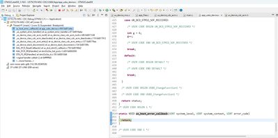

After doing more debugging, the error seems to be triggered by the OTG_FS_IRQHandler, which then climbs up the stack triggering a reset callback. Am I correct in my thinking that maybe the CDC is trying to write out the text when the stack is disconnected thus throwing the error? Or is it something else that is causing the issue. Below is a screenshot of the call stack when the error occurs.
Any insight would be greatly appreciated.
Kindest regards
2025-10-15 8:17 AM
Hi @kumaichi
ux_host_error_callback() is part of the USBX Host stack, used when your device acts as a USB host (e.g., controlling other USB devices).
In your case, the STM32U575 is running a USB device (MSC + CDC) application, not a host. Therefore, implementing ux_host_error_callback() in your device firmware is not appropriate and will not help diagnose or handle device-side USB errors.
