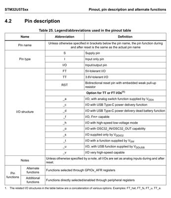

To debug this extra consumption, please provide the package / part number / PCB and also the firmware. Most probably a conflict either in PCB or software. Here are the I/O types - the ones with _à are connected to VDDA . Hope it helps you

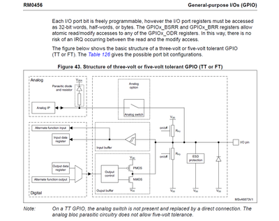

I am not familiar with analog switch circuits,
If there is an analog switch, does the current flow from VDDA to GND when the PushPull setting is set to Low output?
From the schematic in the reference manual, I thought that even if there is an analog switch, the current consumption of VDDA would not be abnormally high due to the VDD port setting.
