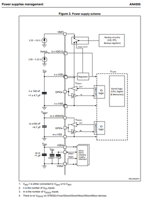

VREF- must be connected to VSSA (to GND as well), as explained in AN4555 Figure 3:

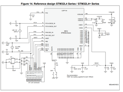

And the reference design for LQFP144.
