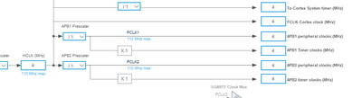

According to what you shared till now:
1) It's not recommended to use any of the internal clock sources (RC based oscillators: HSI, MSI etc) for CAN communication. Please use HSE with a crystal.
2) From your clock configuration you have APB clock = 4MHz while FDCAN kernel clock = 32MHz:
and you need to have fdcan_tq_ck < fdcan_pclk as stated in this knowledge base article:
FAQ: Fixing STM32 FDCAN communication disruptions - APB bus, kernel, and time quanta clocks
Hope that helps.
