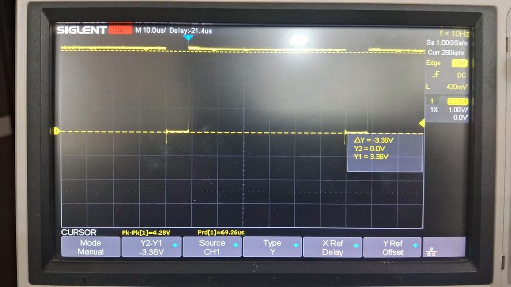

From your oscilloscope screenshot it seems you have that 0x7F which the target is waiting for:
Meanwhile I still insist on the hardware check:
1- Is there a mean to connect with the STM32H7 with STLINK?, to confirm if the chip is alive?
2- If you can connect with ST-LINK, check again your hardware and continuity between STM32H7_TX / USB-USART_Rx and STM32H7_RX / USB-USART_Tx. You need to confirm that part and check if you are using the right pins. You could have a mismatch with what you are really doing and what you are thinking about what you did ;).

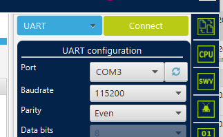

And use CubeProgrammer to connect to the ST bootloader:

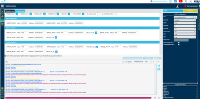

2025-12-24 2:45 AM
USB-Serial is working fine, tested by RX-TX loopback. Still the CubeProgrammer fails to connect.
Attaching snapshot.
2025-12-24 2:57 AM - edited 2025-12-24 2:58 AM
Did you monitor USB-UART bridge Tx with an oscilloscope during the CubeProgrammer connection?
2025-12-24 3:57 AM
The oscilloscope visuals seems 0x7F is being transmitted over TX.
2025-12-24 6:42 AM - edited 2025-12-24 6:42 AM
