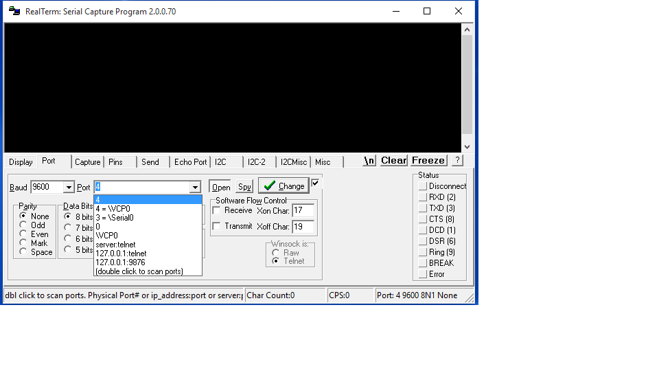

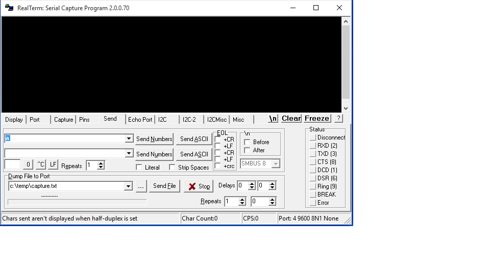

is not getting invoked and hence I do not see the LED getting Toggled :( Also attach here is the Screenshot of RealTerm Settings (1) and thesend tab in RealTerm, where I try to send a character (2). (1)2015-10-08 8:41 AM
