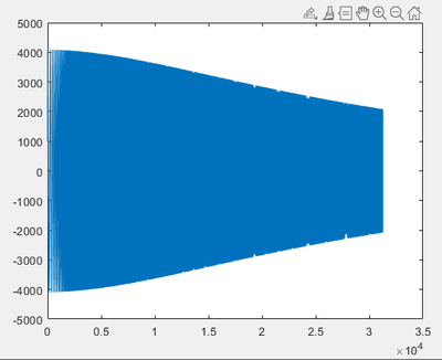

the true response signal is look like:

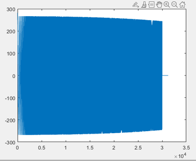

and result that I get:
I should note that the number of loop iterations is an estimate and I want a simple result in first step.
Where am I doing wrong? Is this setting wrong? Is the way of providing data to FMAC wrong? Or its order?

now the filter response is:
but the FMAC output is:
The signal's amplitude is not important now, what matters is that its shape does not resemble to designed shape.
Is there any hint or technique to design FMAC compatible IIR filter?
