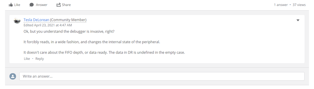

Hello, my problem has been solved. I saw one of your answers in the forum, so I didn't use the online debugging method to observe variables. I think maybe STLINK is consuming my CPU resources and my system clock frequency is only 2MHZ. Thank you very much .

I wonder if this is related to the system clock. My system clock is 2MHZ. I have also tried an 80MHZ system clock and errors are less frequent, but they are not inevitable. I look forward to your reply. Thank you.
2021-09-02 3:04 AM
