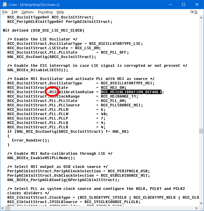

In [STM32Cube_FW_L4_V1.5.0]\Projects\STM32L476G_EVAL\Applications\USB_Device\CDC_Standalone\Src\main.c I see this:
Can't this be the at root of the problem?

Amel N wrote:
The mystery here should be related to the LSE:
I beg to differ.
The target frequency may be off by 2500ppm for a Device, as per USB2.0. The LSE either runs or not - 10ppm or 100ppm should make no relevant difference, unless the 'MSI PLL' (whatever it is) is badly broken.
I'd see the problem primarily in the 'MSI PLL'. There is virtually no relevant information on it in the DS/RM, which is a bad sign in itself. There's only a switch-on bit and a rather irrelevant (at least for USB usage, which appers to be the primary reason for this feature) settling-timing in the DS. I don't believe in various magics - IMO, working of things has to be solidly documented. Yes, I am old fashioned.
The mysterious content of RCC_ICSCR.MSITRIM just enhances suspicion.
There is also no relevant infomation on the MSI trim itself (which I'd ask ST to supply into the RM/DS, too). The frequency/value diagram for HSI in RM indicates, that there may be jumps in the frequency at certain values. Are there such jumps for MSI too? Can't the 'magic' be broken in that it does not take into account such jumps?
I am afraid this is something which can't be resolved at the user level and desperately needs factory attention.

2. I'll be fixing the blivits that Jan is kindly pointing out -- Unititialized vars , MSI/HSI goof
The register dump shows 0 which is by LUCK I guess.

Estimating from that trim graph for MSI, the 'tuning step' around the center is roughly 10-20kHz per +-1 in TRIM, which at 4MHz which is the nominal frequency for that graph converts to 2500ppm... it is thus next to impossible to manually trim the MSI to the precision required for FS USB Device.
That also IMO precludes an internal mechanism which would change MSITRIM.
