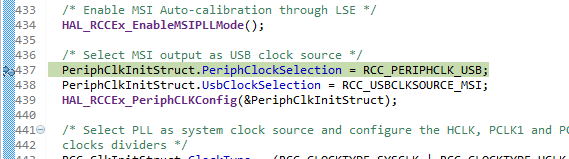

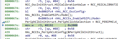

Not stuck the LED in yet and this was QUICK by an unproficient user (me)
Breakpoint inserted HERE just after it gets set in line 434

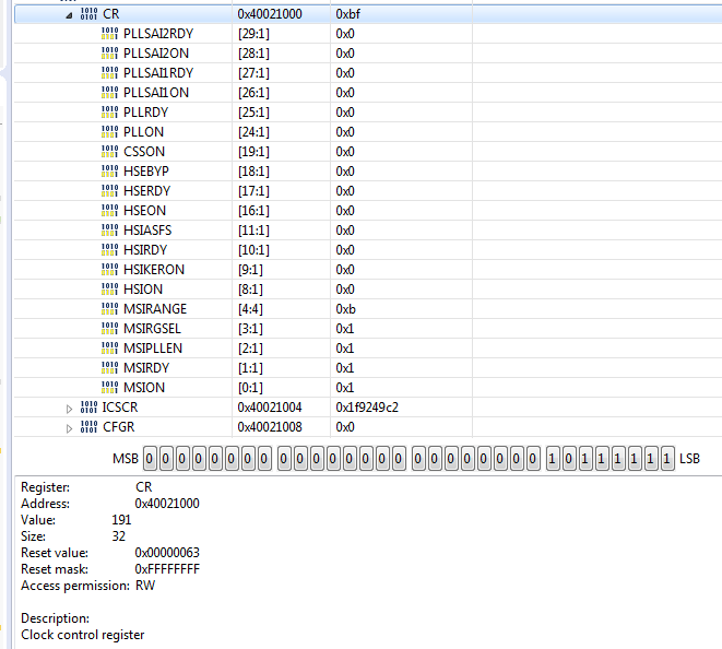

RCC_CR Register

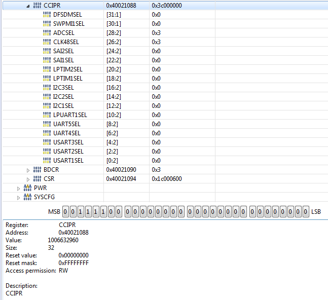

Thats the important one. I'll have to play more to get ''ALL'' of them on here.
Those other 2 bits floating around on the left.... = RCC_CCIPR.CLK48SEL - No Wrong register I suppose..
BUT THEY ARE IN THE RIGHT BIT SPOTS ! I'll look.

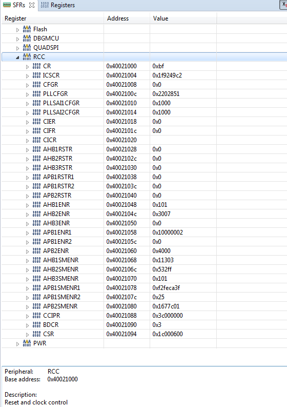

In the debugger, read out and post the content of all RCC registers.

Better?

And running via debugger, I can pause it randomly and the RCC CR and CCIPR are correct. As shown above but the CCIPR has the upper 2 bit that are 1's are now 0's since I'm back to the raw demo code. (No AtoD's)
