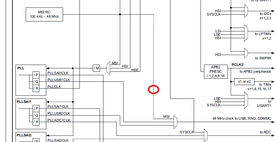

RE-READING the MSI Autocal operation and looking at the clock tree diagram seems to indicate that the MSI itself is being put into a PLL MODE. So MSI could be output from MCO if that was deemed necessary. I was initially thinking PLL since it said 'PLL'. AS in the real PLL being driven by MSI.
But no
They appear to mean the MSI ITSELF ACTING as a PLL.
And so far I don't see how you control that AUTOCALING. There is SOFTWARE CALIBRATING but how that intertwines with the other mystery auto cal is -- well......A mystery.

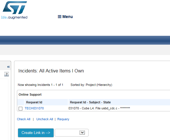

Still no word on my critical TECH031634 online support request outside of the auto-generated email. And the following worries me. when I go to the Online Support, I see this
Note this is ALL ACTIVE ITEMS???. Maybe TECH031634 doesn't show up because there has been no initial response?
Still worrisome because it is certainly ACTIVE from MY standpoint. So since its making me think... Why isn't my new issue showing up? I just go fishing around by selecting the HUMAN BODY symbol upper right, then MY ACCOUNT, then ONLINE SUPPORT(RIGHT), The list of 4 items STILL doesn't show the TECH031634 However if I select SEE ALL on that page, THEN I can see the TECH031634 as ASSIGNED, plus ALL of the ones I've submitted. And ''ASSIGNED'' is possibly as official and efficient as a computer ASSIGNING it from a list of folks (Fred - next in line - lets say) and good old Fred is on a 3 week vacation right now.
If someone is really looking into it, is it too much to ask for just a simple HUMAN response to that effect.
