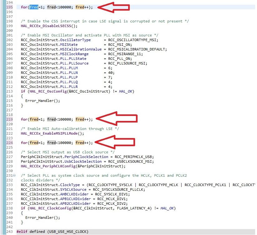

Fred *MIGHT* have it fixed for now.
Fred?
Add VAR in main
uint32_t fred = 0 ;
Then -
Add those lines on my Nucleo that misbehaves - 48.005MHZ out MCO pin for MSI.
Comment these out - TURBO! 57.488MHZ
Repeat 5 times.
Same results. LINES IN = GOOD - LINES OUT = BAD.
I let my contacts know.
And - Yeah maybe just ONE of those lines might do it.
More tomorrow I'm sure. (I need to grab one or all of the production Duds...)

Omit Fred, fix the bug I told about above (instead HSICalibrationValue should be MSICalibrationValue).
