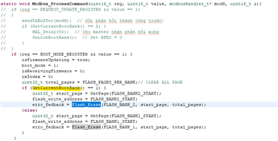

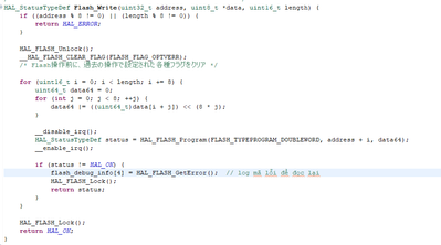

I'm using STM32G474 with dual-bank Flash enabled (nDBANK = 0) and booting from Bank2 (BFB2 = 1). I'm implementing OTA firmware update by writing to the inactive bank while executing from the active one.
The update from Bank1 → Bank2 works fine.
But in the second update cycle, when running from Bank2 and trying to write to Bank1 (starting at address 0x08000000), HAL_FLASH_Program() always fails on the first double-word.
I have:
Verified that Write Protection is disabled (checked in STM32CubeProgrammer)
Unlocked Flash properly
Erased the target pages beforehand
No PCROP or secure area configured on Bank1
Flash error flag is HAL_FLASH_ERROR_WRITE_PROTECTION sometimes (even though WRP is not set)
I found some similar cases reported online (e.g. this one) where users mentioned that writing to Bank1 from Bank2 fails silently.
Is there an undocumented silicon limitation on STM32G4 when programming Bank1 from Bank2?
I would appreciate any official clarification or workaround from ST or others who solved this.
Thanks in advance!

2025-05-22 5:10 PM
Hi ufolek
Yes, I’ve encountered a very similar issue and managed to solve it.
In my case, the MCU is not an STM32L4A6, but an STM32G474.
The root cause turned out to be related to the remapped memory layout when booting from Bank2 with BFB2 = 1.
When the device starts from Bank2 (with BFB2 = 1 set), the memory map is remapped as follows on STM32G4 series:
Bank2 is remapped to 0x08000000 (the usual start address),
Bank1 is remapped to 0x08040000 (instead of its usual 0x08000000).
So if you try to write to 0x08000000 from an application running in Bank2, you're actually attempting to write to Bank2 (which is currently executing), not Bank1 — and that causes the write to fail.
To write to Bank1 while executing from Bank2, use the remapped address 0x08040000 instead of 0x08000000.
Hope this helps!
2025-05-26 6:33 AM
Hi cuong!
Thank you for your response. It reinforced my belief that this would eventually work out :)
In my case, I didn’t encounter that particular issue. I was always writing to the physical address of BANK2
In the end, it turned out that the culprit was the FAST_PROGRAMMING option I had been using. After switching to DOUBLE_WORD programming, the issue disappeared.
Now OTA works alternately between both banks!
