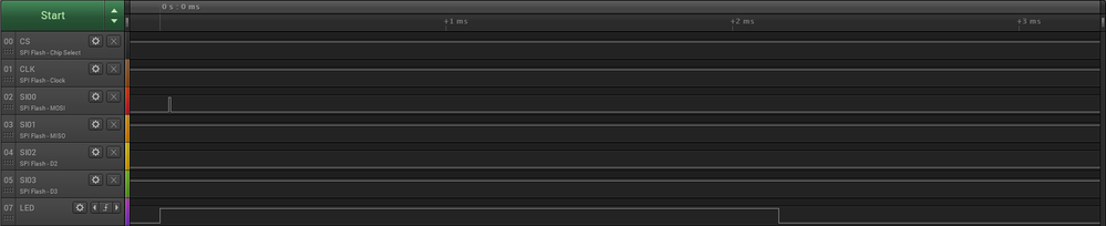

I am using a STM32L452 MCU with a quadspi flash from Micron.
I configured the board using CubeMX and have tried making a test code based on the example in: STM32Cube_FW_L4_V1.15.1\Projects\STM32L476G-EVAL\Examples\QSPI\QSPI_ReadWrite_DMA
I'm trying to read the Manufacturer ID on the flash but I'm not getting any of the signals on the datalines.

2020-04-01 7:22 AM
Turns out there was a faulty connction on the PCB.
Thank you for the help though.
