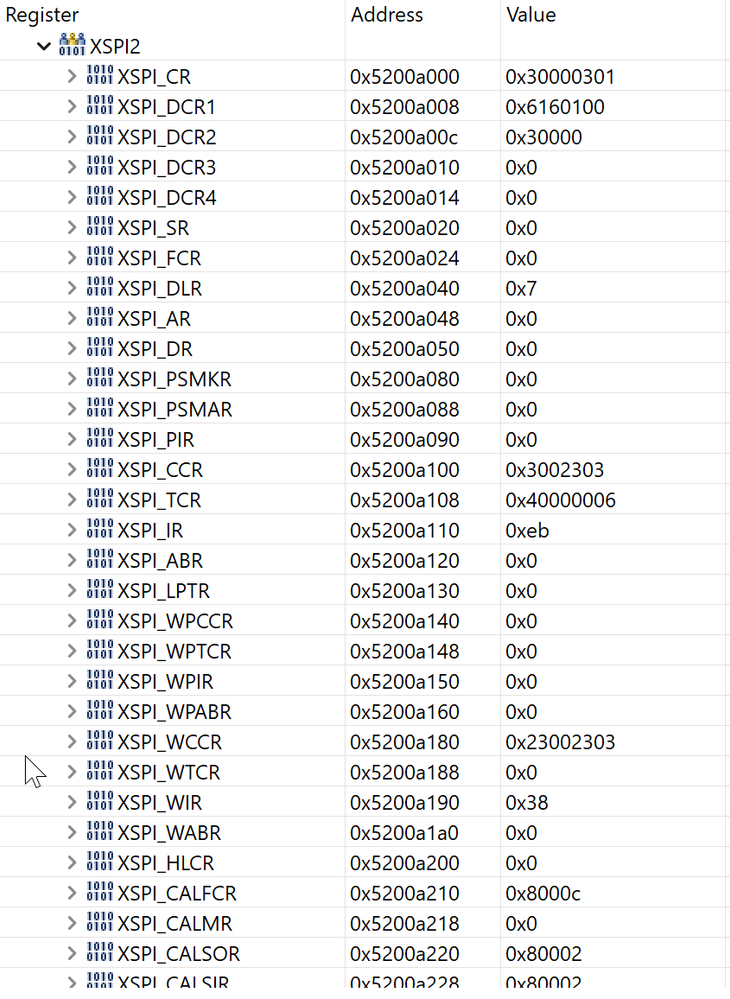

EXTMEM_Init(EXTMEMORY_1, HAL_RCCEx_GetPeriphCLKFreq(RCC_PERIPHCLK_XSPI2));When system startup, the SW can properly initializes the PSRAM with reset, toggle-burst-boundary(chip specific feature), readID and enabled to memory-mapped mode successfully. Below image shows the registers after init:

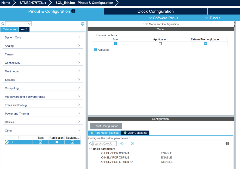

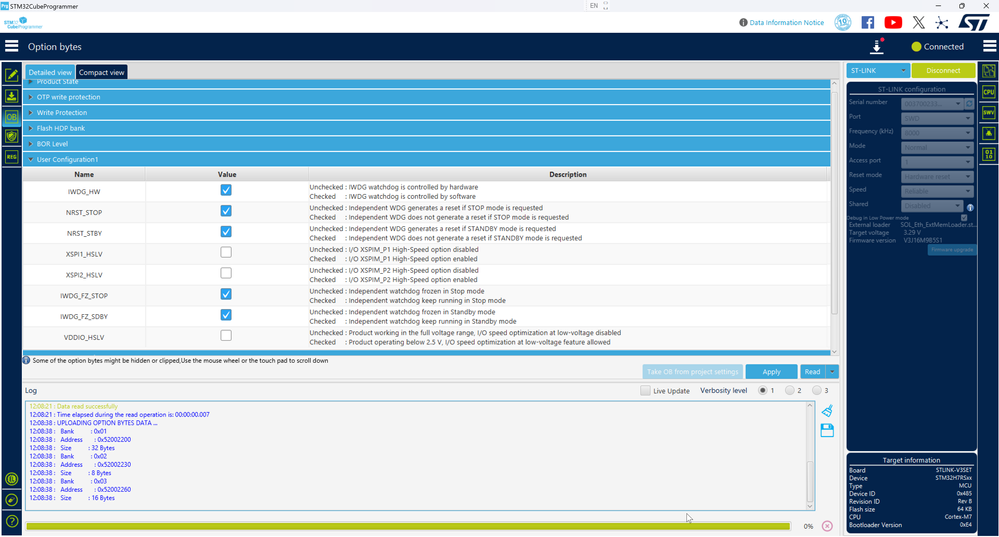

For HSLV, I checked the high-speed-option are disabled on both XSPI 1 and 2. See:
But the HSLV are enabled from MX->SBS. Shall I disable it too?

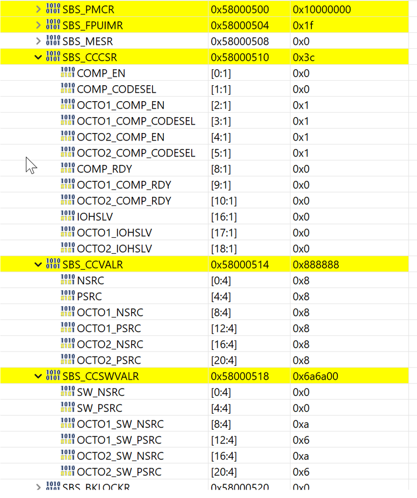

2) Then apply SW I/O compensation on XSPI (Follow workaround from Errata 2.2.15)
The value of flash memory at address 0x08FFF840 @3.3 V is 0xFFFFFFFF. So we go with case-1: The calibration value from register SBS_CCVALR is 8. The result shows the SW compensation does not help in high speed, and a little bad with low speed:
| XSPI-2 Clock (MHz) | Total Bytes | Error Bytes | Error Rate |
| 133 | 8MiB | 527700 ~ 685694 | 8.57% |
| 66.5 | 8MiB | 800 ~ 1191 | 200 PPM |
| 33.25 | 8MiB | 13 ~ 30 | 4 PPM |
Double check the SBS registers:
Summary:
All these can't fix the unstable problem. Any suggest?
