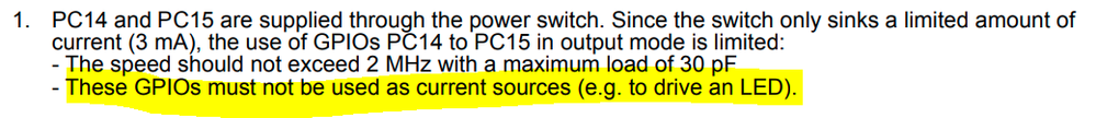

Also be aware that PC14, and PC15 have much more limited driving capacity than other pins as they are powered from the power switch. The datasheet says you "must not" source current to drive LEDs with these.
2021-12-02 11:11 AM
Thanks. I've decided not use those anyway!
